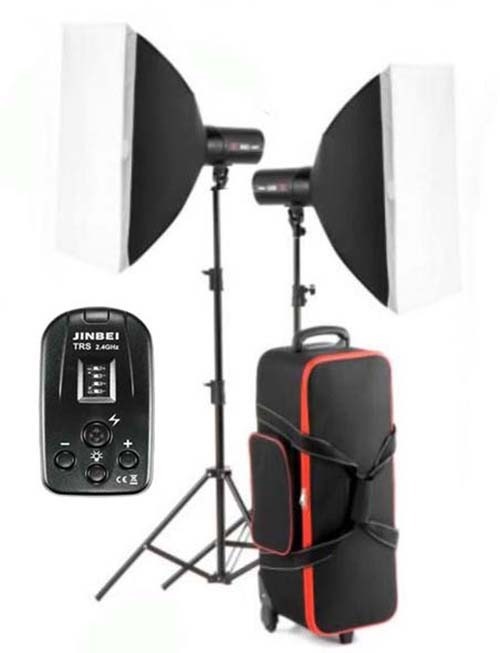

Bought this kit after having it recommended to me. t'Is a Chinese brand making some in roads here in Australia at least. I was looking at an Elinchrom set which is obviously more well known. But I just couldn't go past the value of this set. To get the two strobes, stands, wireless trigger and 2 softboxes for this price meant I could afford to add the battery pack as I don't have a studio to work with so most of my shots are on location.
Also got a 22" white beauty dish with grid and sock from AliExpress (Alibaba) which was my first time getting something from there. I know they sell heaps of fake things, but it's a tin, powder coated dish. I really couldn't care less about authenticity.
http://www.protog.co...an/JBDM34002KIT
Specs
Guide Number: 66
Recycle time 0.3s - 1.5s
Power adjustment: 6 stops, 1/1 to 1/32
Flash recycle notification: LED light, audible buzz, or LED modelling light illumination
Flash Duration t=0.5 1/2000s
Colour Temperature 5500K +/-200K
Trigger methods: Sync port, Infra Red, or built in 2.4GHz wireless
Trigger channels: 16
Flash Casing: Alumimium
Weight: 1.7kg per head. Kit Weight: 8.8kg
Dimensions: 124mm diameter x 216mm long
Now.... Just need to learn what I am doing with it all.

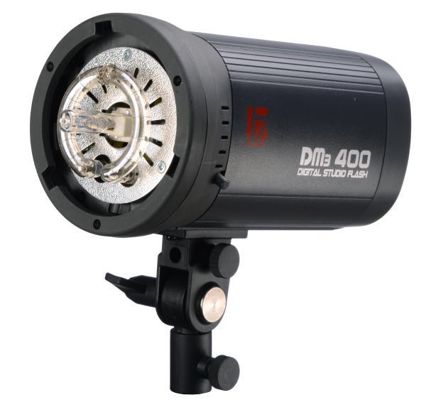

  • 6,455 posts
Seems like a good starter set, except that I can't get 400 J and a GN of 66 to match. A GN of 66 measured with a 55° reflector is about 63 with the industry standard 62°. This gives an output of 250 J. A 400 J unit has a GN of about 80.
This doesn't mean much as long as you only use these flashes, but can be a problem when mixing units from different makers. The power outputs of most cheap units are pure fantasy anyway. This lower power than advertised makes it more probable that the flash will work reliably without visible cooling. This would be a concern if it really was 400 J.
It is always a good exercise to measure the guide number in the configurations you will use the most and write them down as this makes it easier to get predictable results from the start. GN is just distance between flash and subject multiplied by the aperture tested at ISO 100.

My totally unscientific testing (based on what you stated) with a light meter set on ISO 100, power set to one on flash (with 55° reflector) gave me a result of f8 when held approximately a metre away. So this would be your GN of 80 yeah?
New to all this and so don't understand any of it.
  • 6,455 posts
No, this is only a GN of 8, strange. Does the flash show power steps instead of reduction steps, so that power 1 is 1/32 of full power and power 6 is full dump? A GN of 66 should be f/6.6 at 10 m...
