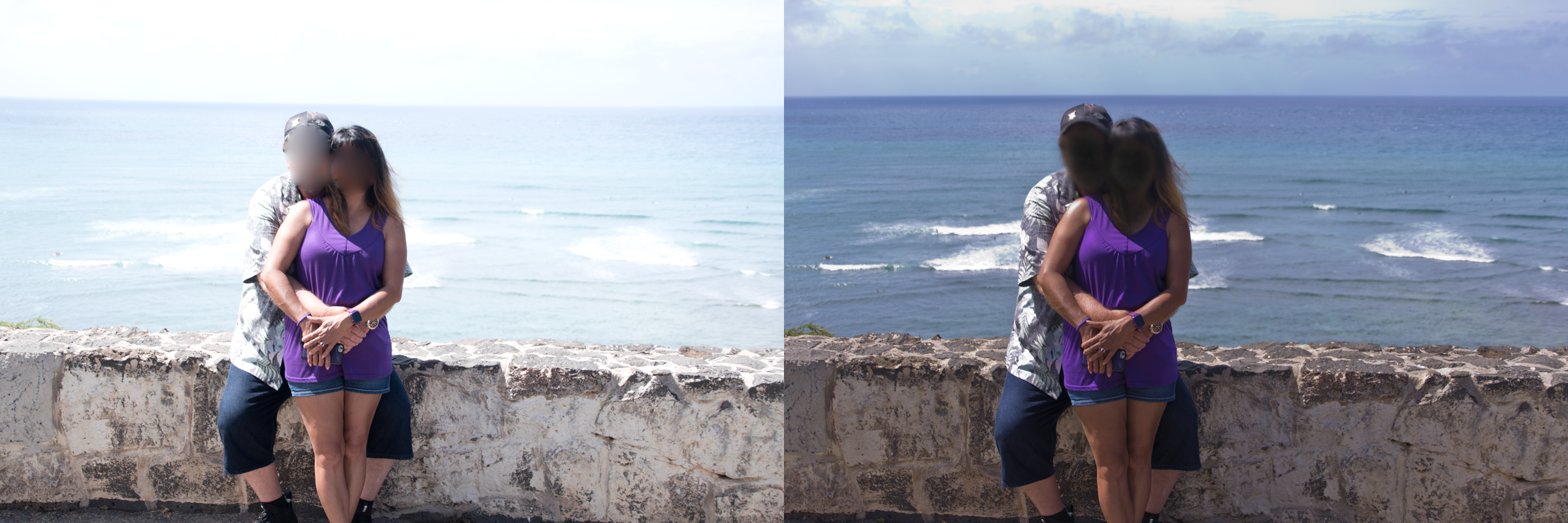

I have no clue about the newer versions of Photoshop but on my CS5 there is a slider for Recovery.  On over blown windows like that on the Raw/DNG files it dials it down the blown out area so that you can somewhat see the outside items.  Its not a perfect result but its better than all white glare. Maybe the guys who use the newer versions can chime in as to the current versions of PS ability to do this.

I think I shall have to find a photo and do a before and after to show you.
#14
Nikon Shooter
Nikon Shooter
  • 1,360 posts
  • Location: French Canadian living in Central Europe
Please do, my friend! :)
#15
Fletch
Fletch
  • 404 posts
  • LocationHawaii
https://s3-us-west-2...1fce649/s/0.png
My GF daughter and friend, faces blurred since I didn't ask permission to post.

Ok Irwin, I understand where the misunderstanding is.
High or Hot keys defines your example: values between 235~250/255.
Burnt is containing almost no information: 245+ and will generate weird greys.
Blown contains NO info whatsoever: 255/255, there is nothing to recoverā€¦ pure white.
In the OP picture, the windows are pure white = blown.
